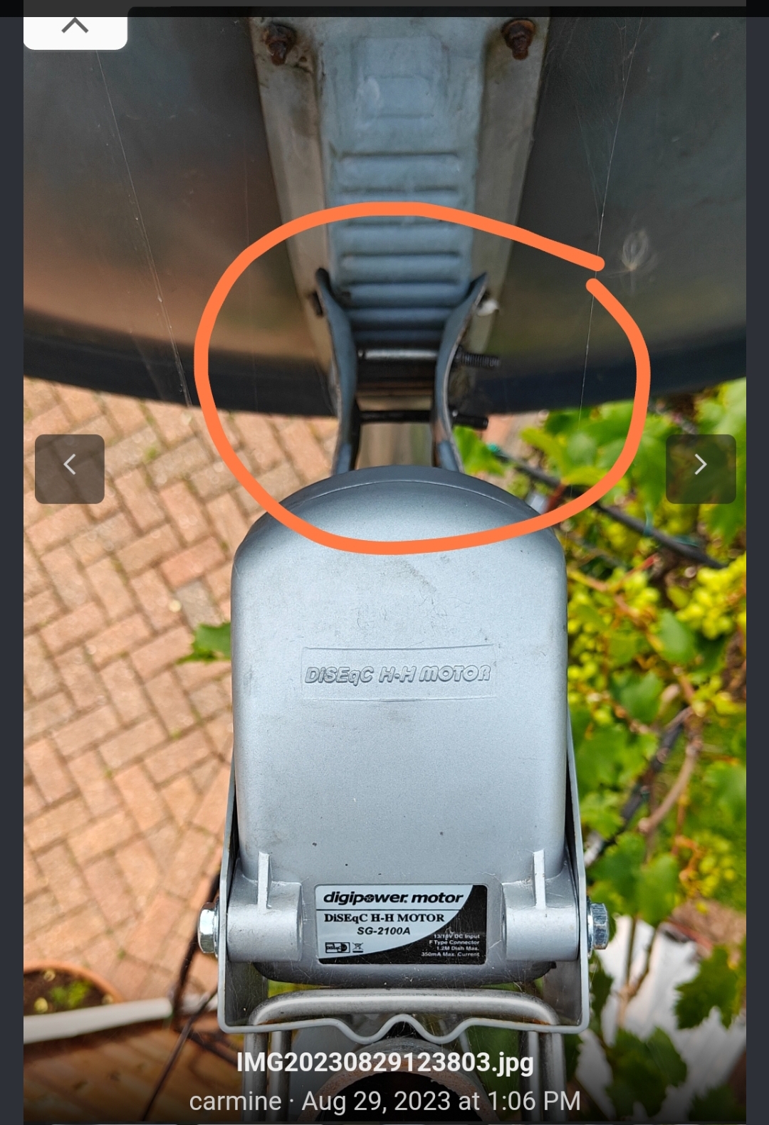

Looks to me that the clamps on the motor have been overtightened. You can see the bends in them, this will have deformed the other bracket on the motor side and could be causing your alignment issues.

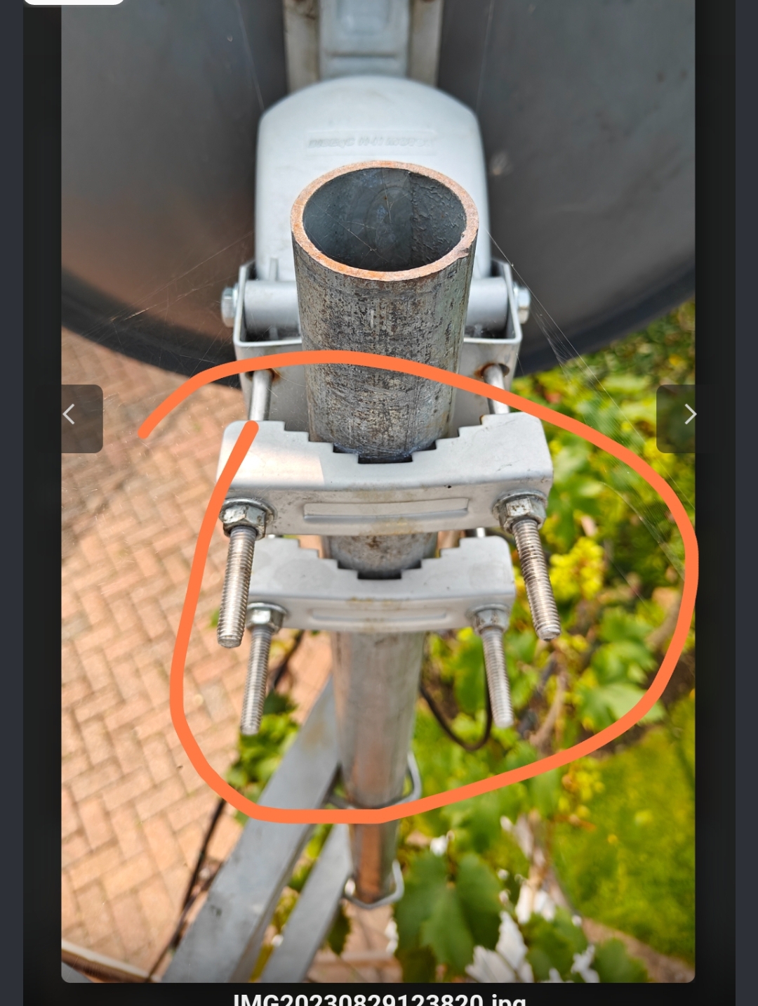

2 issues I can see without looking further
Over tightened and misaligned brackets
Yes your right -
The first photo on here you circled well that when im up on ladder and motor moves I noticed where you circled how ever tight its been tightened there is alot of movement there through wear and tear unable to fix this prob without getting a new dish I suppose unless any one on this great forum has a possible cheap fix ?
and second photo you circled yes its been tighened too much but if brakets are bent slightly can it still be fixed ??
