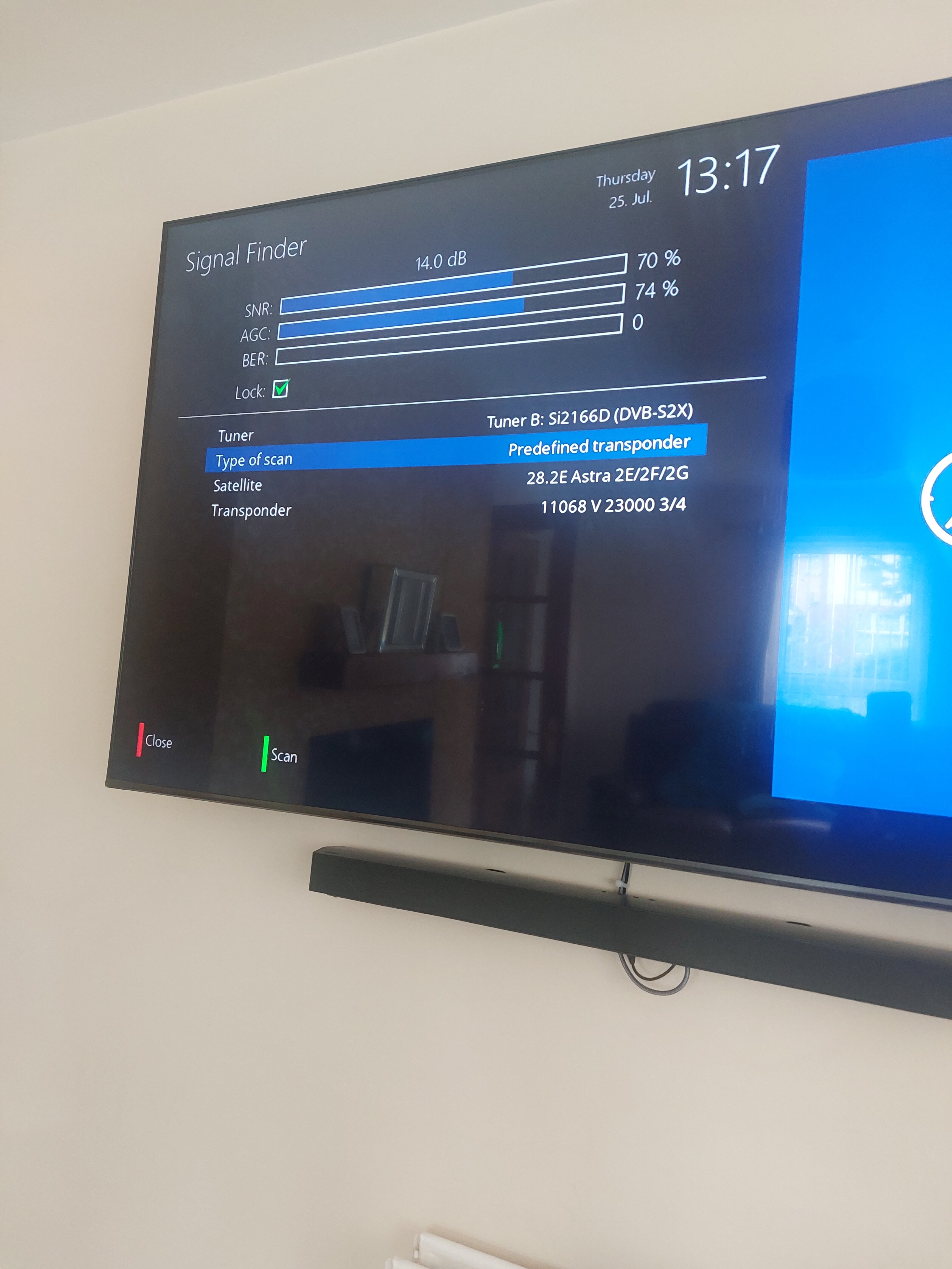

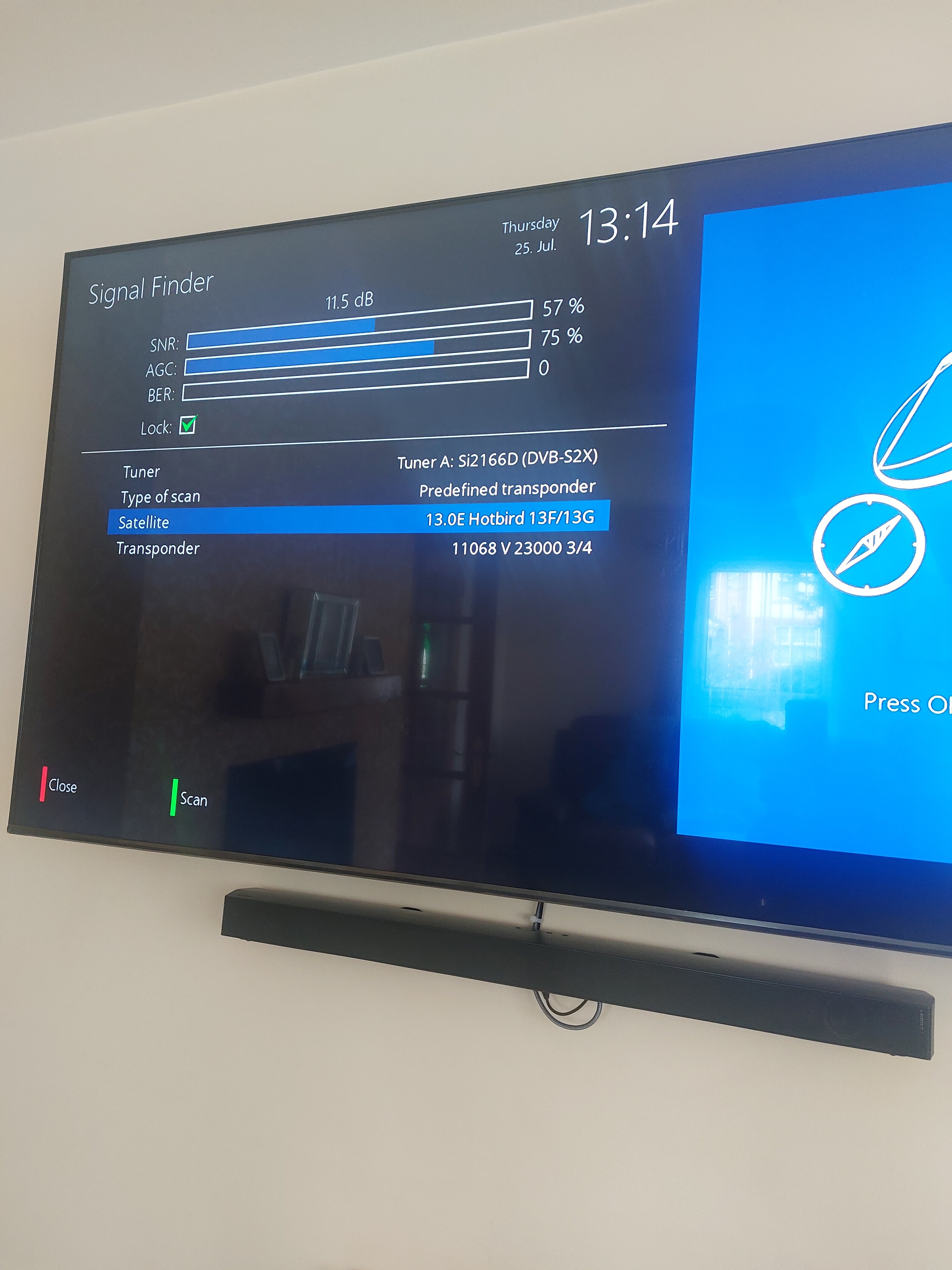

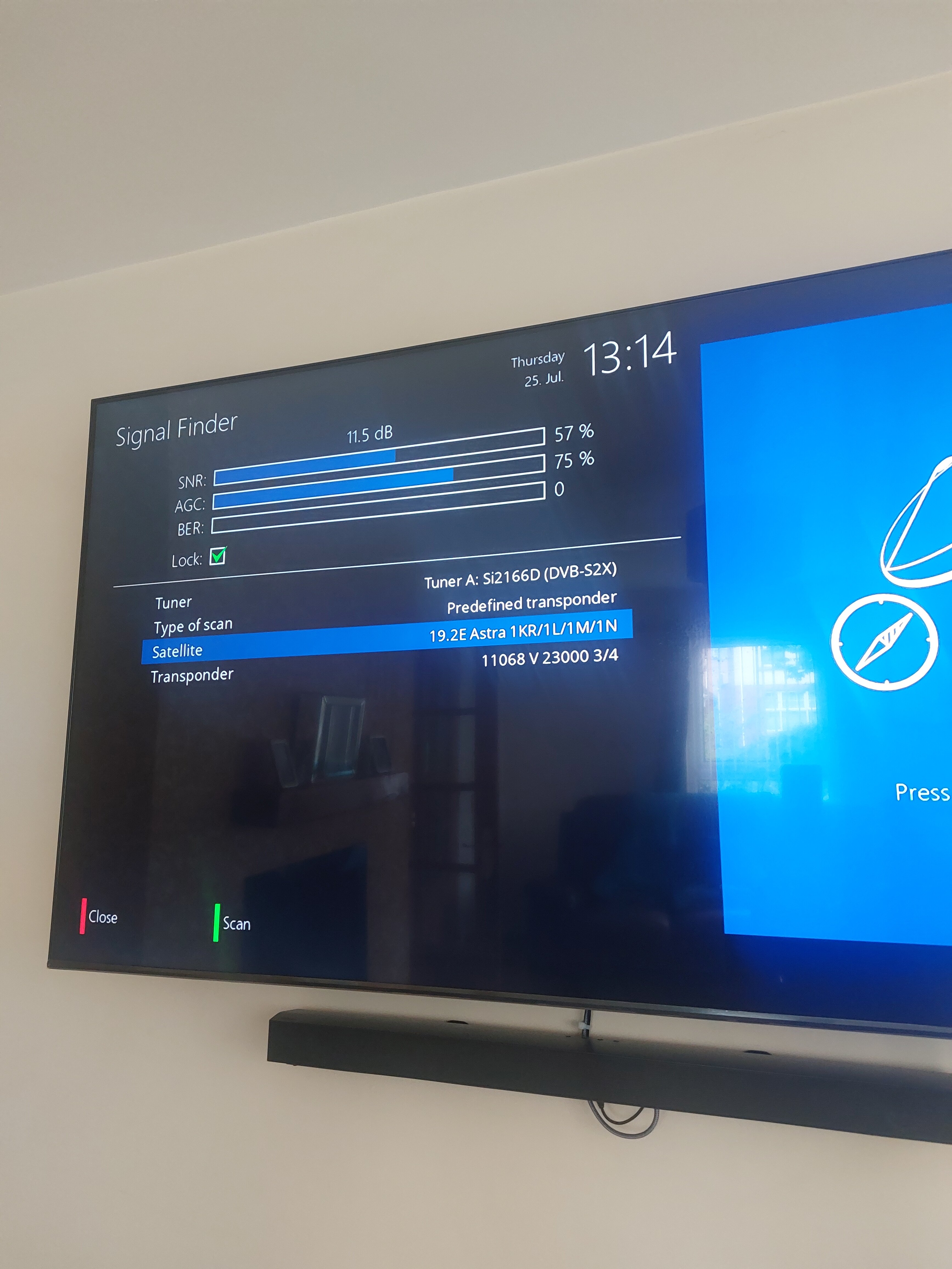

I can only advise what works best for me
I have completed 6 of these installations for
Family and friends. It took no time at all when
I had found the main focus l.n.b 19.2 east
This is the S.N.R AGC readings from the
Multi sat dish i posted earier .Singal finder
isn't totally accurate
I was going to compare, but you are using the same freq on all 3 sats, but 11068 V 23000 3/4 isn't used on 19.2 or 13
Yes its doable but you would get a better result with the triax dish. The triax holder as you may notice has a tilt angle built in to make tracing easier. From what I recall the sky dish was designed specifically for the sky lnb but cokeaddict has it working. The only part of a sky dish that I would use use is the wall bracket and remember bigger is better.
