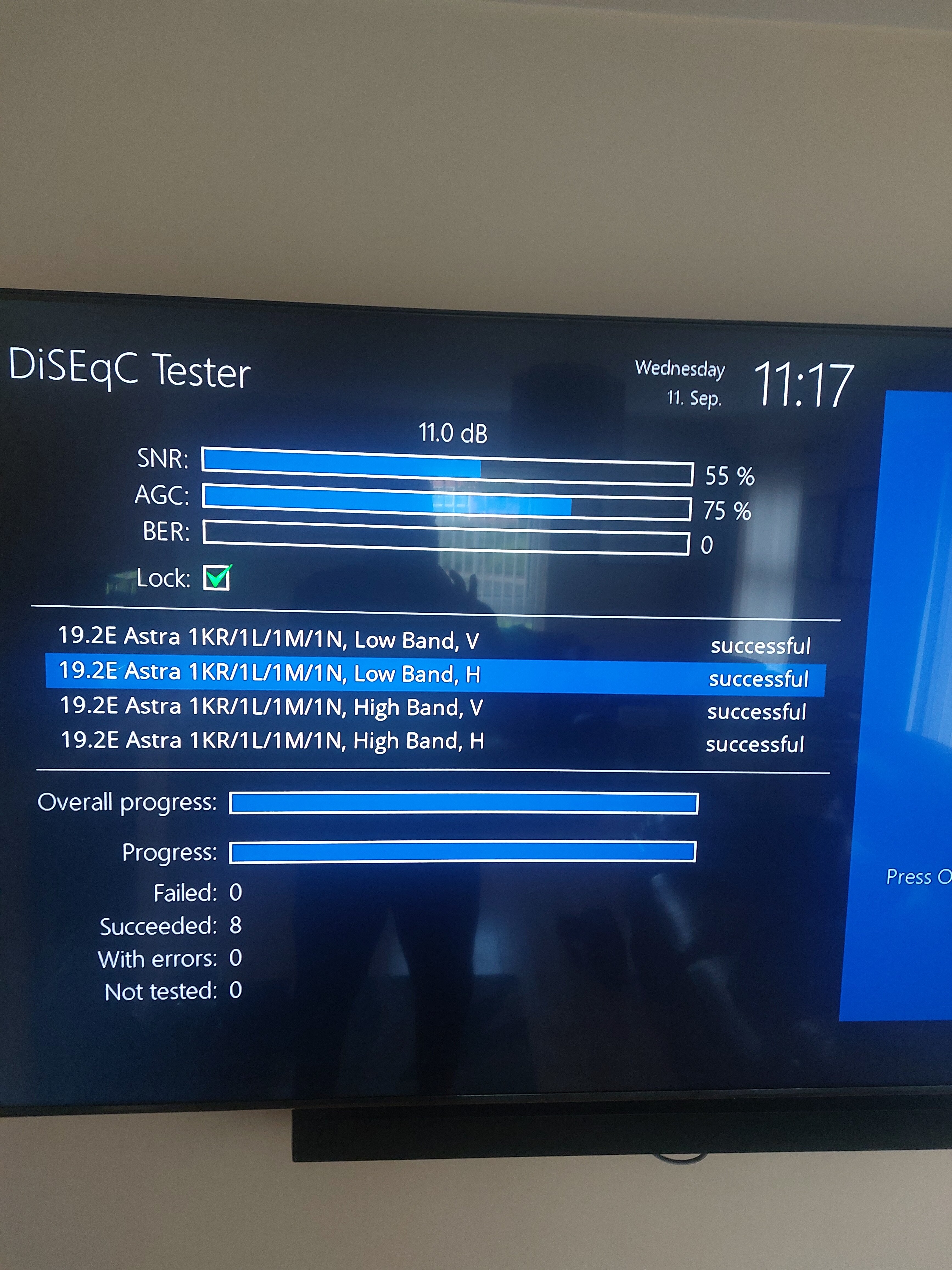

Your installation , are you sure your azimuth
Angle elevation Angle skew angle are 100 percent. Depending on what reciever image
you are using there is a plugin you can install
from system plugins called DISEQC TESTER
You can check that there is successfully readings between the Low Band V and H
And High Band V and H off your transponders

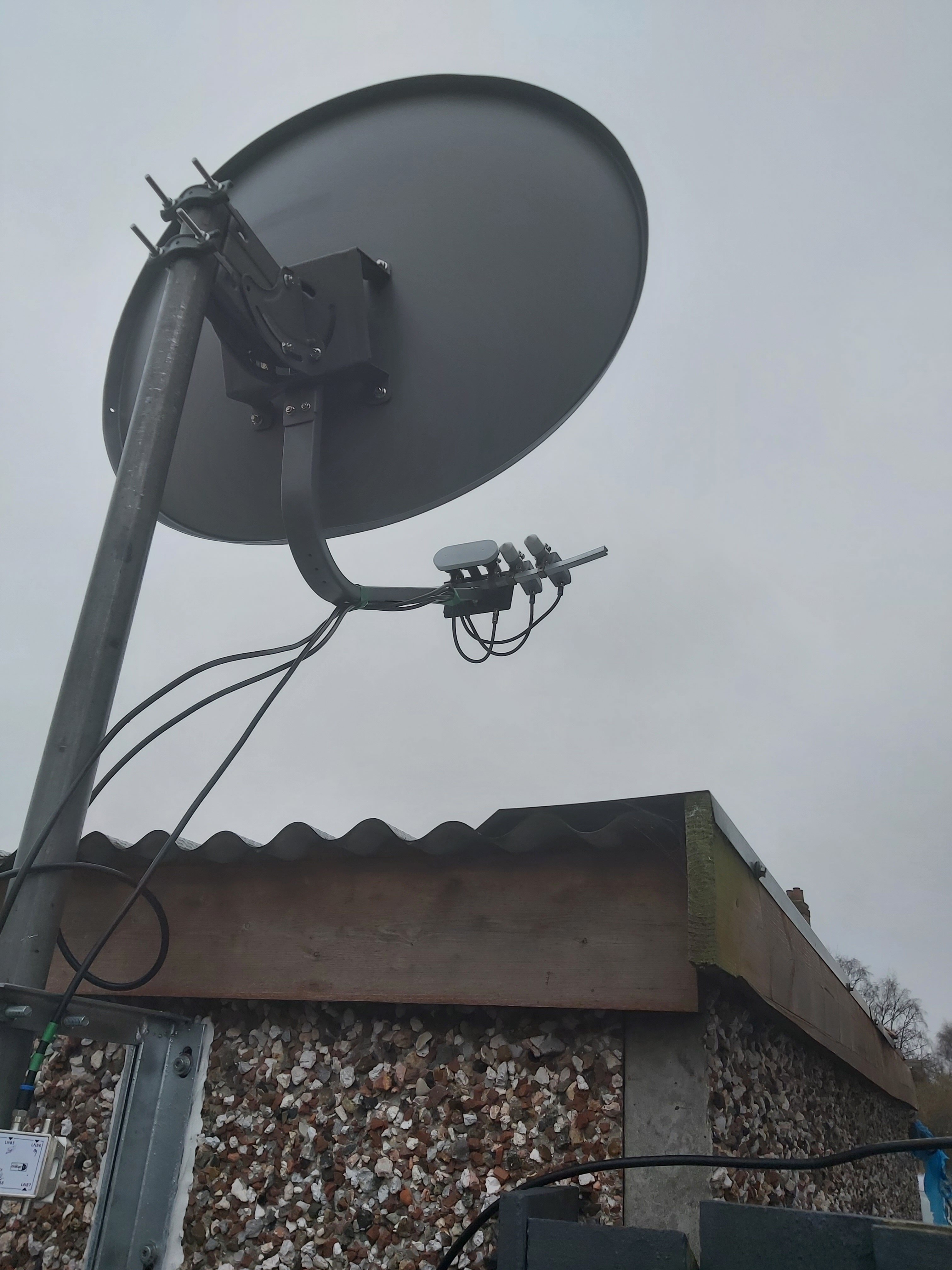

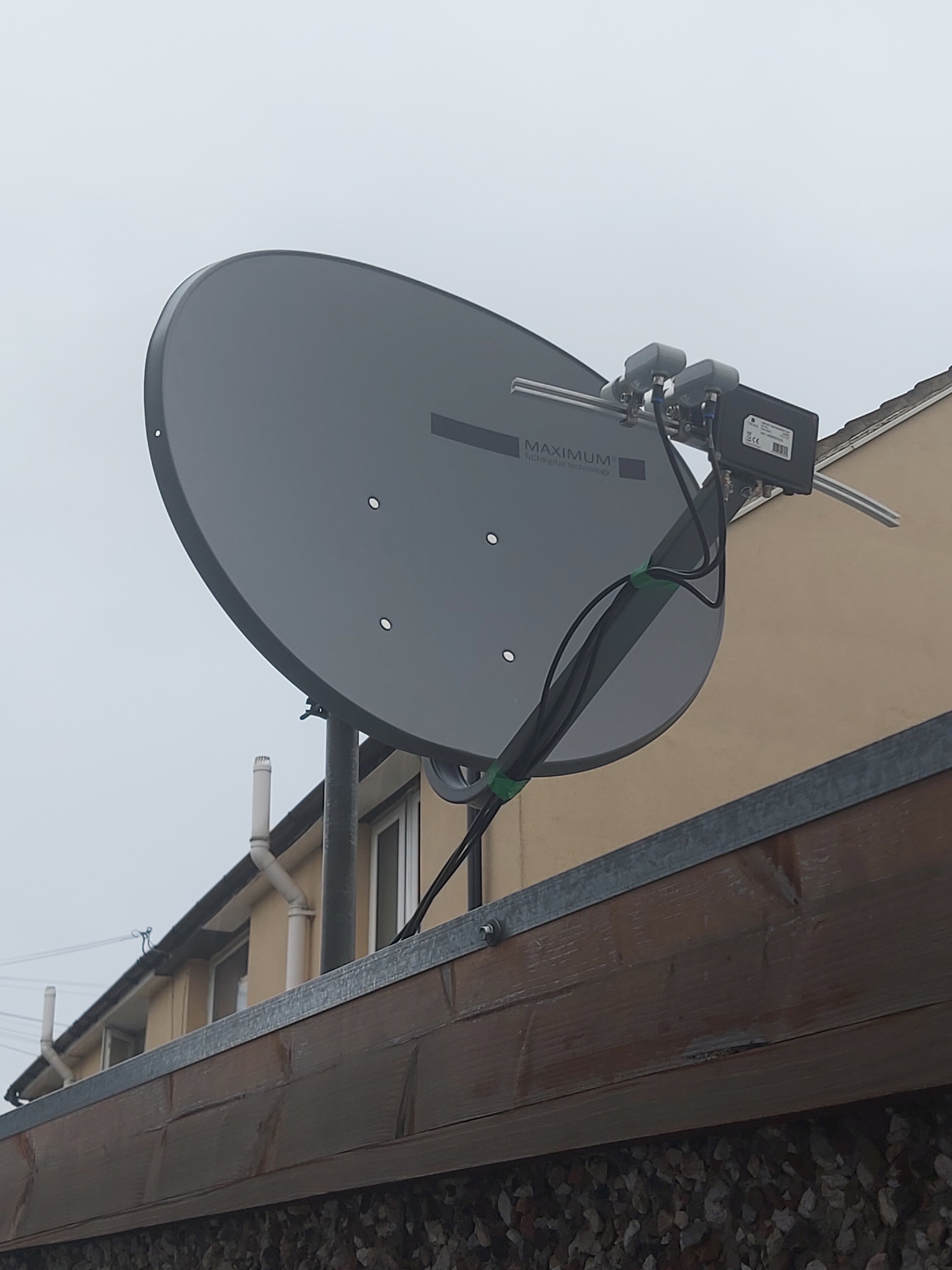

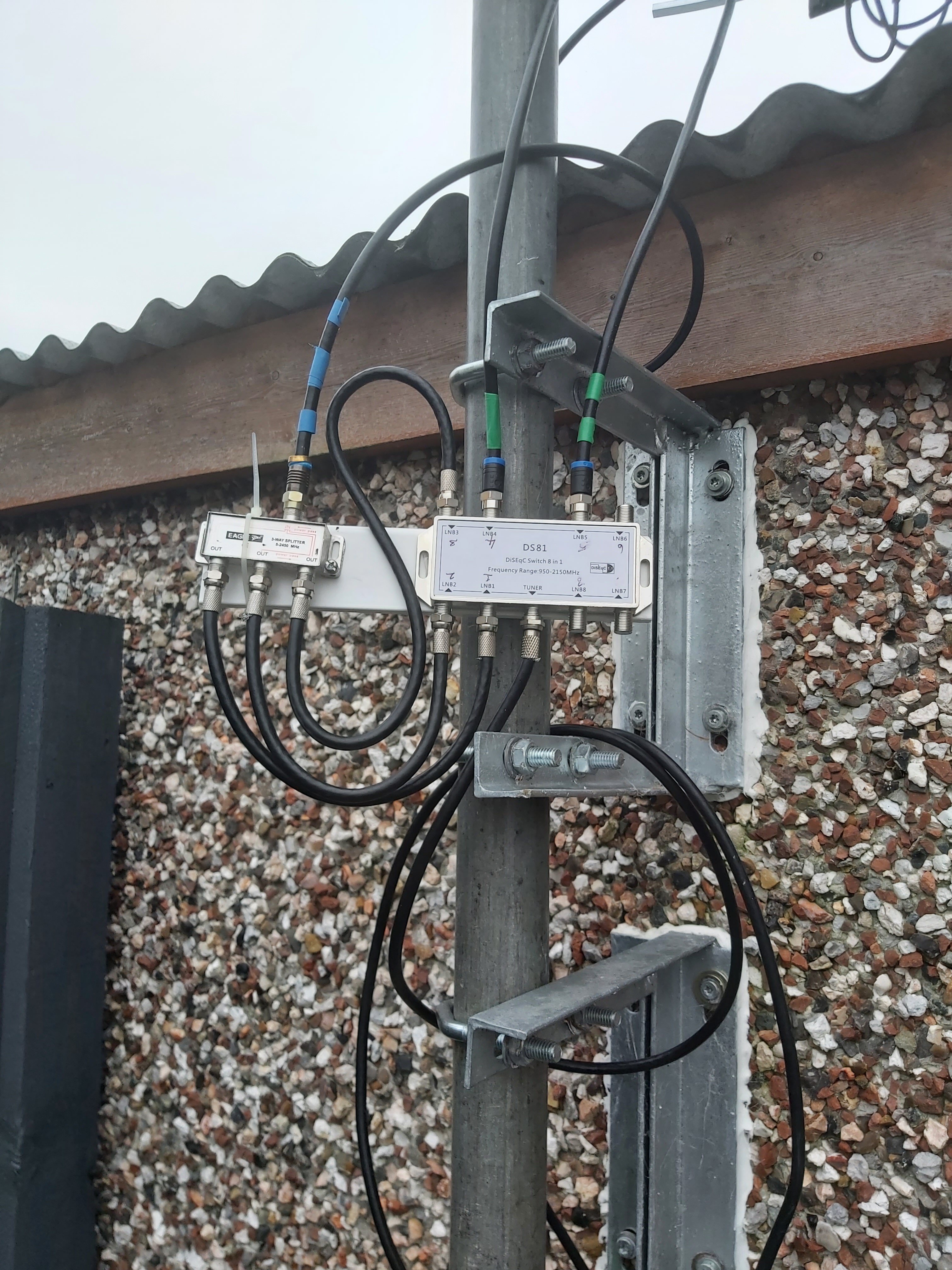

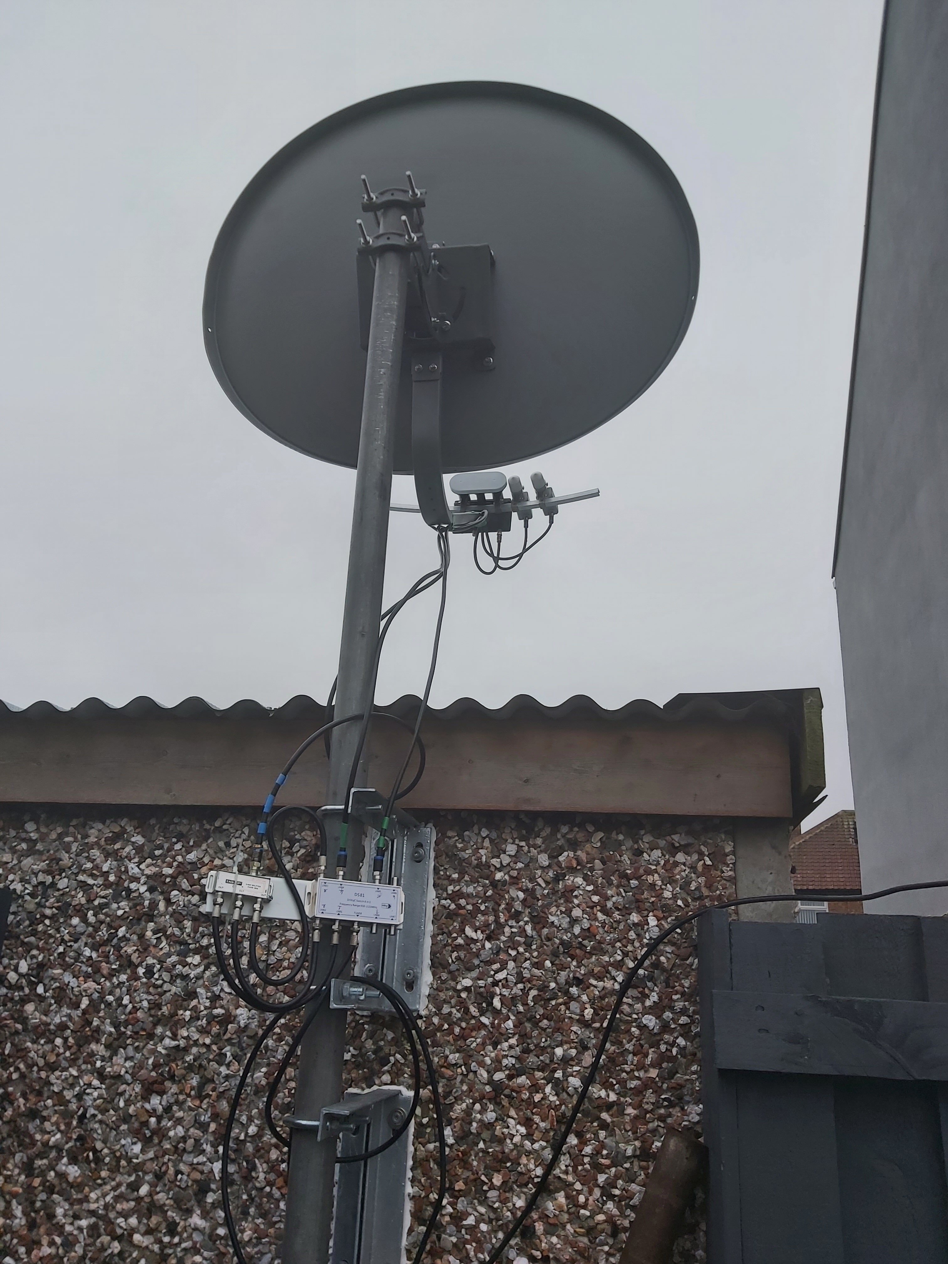

I have still been tinkering with multi lnb set ups.
Using a Maximum E-85 Multifocus Satellite Dish
On lnb arm I have a triax multiblock lnb 13e, 16e and 19. 2e connected to a 3 way fully pass through splitter, the 3 outlets to port 1 = 16e, port 2 = 13e and port 3 = 19.2e on a 8 x 1 diseqc switch.
2 single 23mm lnbs 1 to 23.5e port 4 and 1 to 28.2e port 5.
I have also had 9e working , but at the moment need more lnb holders to fix on lnb rail.
When fully set up the cables will be tidied up.

I gave up with the triax multi-lnb holder and the Zone2, as I kept loosing signal on 28.2E in heavy rain or if the wind picked up.
Ended up putting the 80cm triax back up with a motor on it and fitting the Zone 2 fixed on 28.2E above it.

I found using Triax multiblock lnb on both a Triax 80cm dish and the Maximum E-85 Multifocus dish.
I have modified the lnb holding brackets on both dishes getting better results.
I am still tinkering, so I believe a better signal is possible.

I use the 8 x 1 diseqc switch to allow other satellites to work on my reciver, at the moment 5 satellites are connected to the GTmedia V8 uhd, hoping to set up more.
