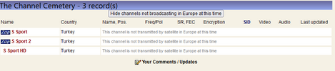

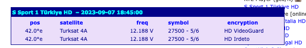

Is anyone able to see S Sport on 42e? I think I was told a while ago that they were no longer broadcasting maybe, but LiveonSat is suggesting they are showing the France v Ireland game tonight. I've tried scanning, but no luck so far.
