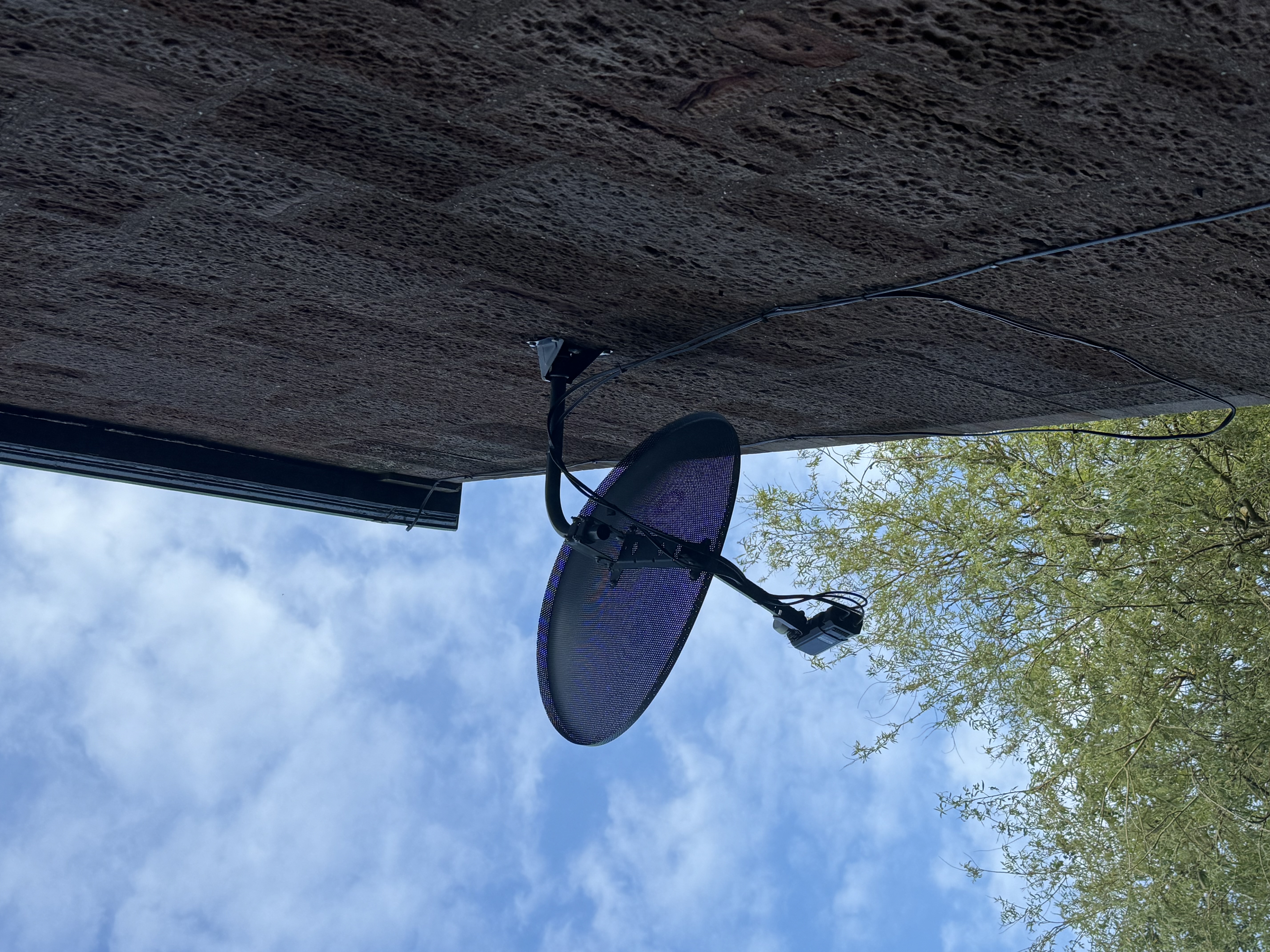

Hi Guys looking to order a viark. Is it worth getting one if I only have a system that can clear 28.2. Will this work for using the sky hd channels on the box? Thanks
Just be aware that if you have a wideband LNB on your dish then for it to work with the Viark you would need to change the LNB to a standard HD type.

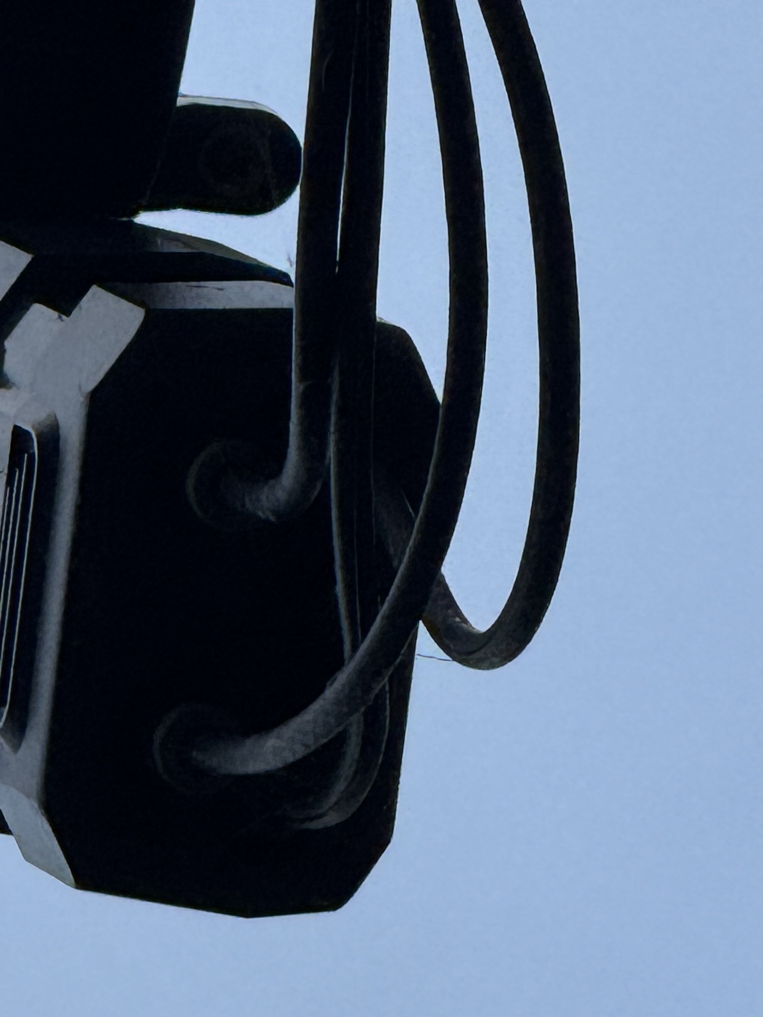

Is there a way to check if my lnb is a standard hd type?
I’l
It Does actually look like 4 when I zoom in to be honest.
I think you have an EL010 lnb, a smart hybrid lnb. If that’s the case, you should be good to go. You won’t even have to switch the wires around on the lnb.

Think your correct mate looks the same as this SKY 010 Hybrid LNB 6 Output 2 x Wideband + 4 Quad - Freesat/ Sky - 4 Months Use | eBay
Looks like a zone 2 dish as well so possibility to add another LNB for 19.2 or even 16e but probably not both
Yeah , looks like your good to go mate , doesn't look like it's got 6 ports ( if it's only got 4 ports then 2 would be for sky Q , just use one of the other ports for your viark .
