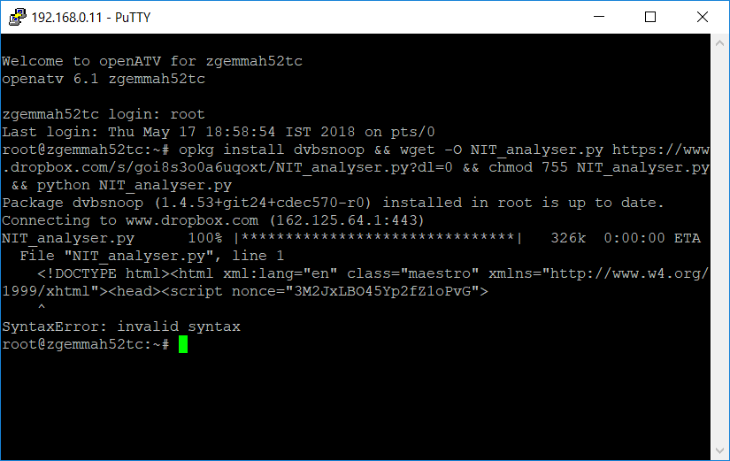

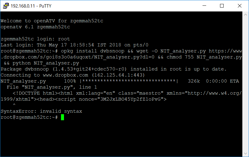

Download the NIT_analyser_20181107.zip file attached to this post.
Unzip NIT_analyser_20181107.zip
Ftp NIT_analyser.py to tmp
Telnet/Putty
Code:
opkg install dvbsnoop
Then
Telnet/Putty
Code:
cd /tmp
Then telnet
Code:
python NIT_analyser.py

I've done the auto scan like you said mate, but only channel 5 clears? for some reason my bbc1 is set to east midlands.
going to try that command now on channel 5 :)
You need 1 to 5 SD working, after you have run the command for 41003 for testing set your tuners to 42650 and run a manual scan and see if 1 to 5 clears.
