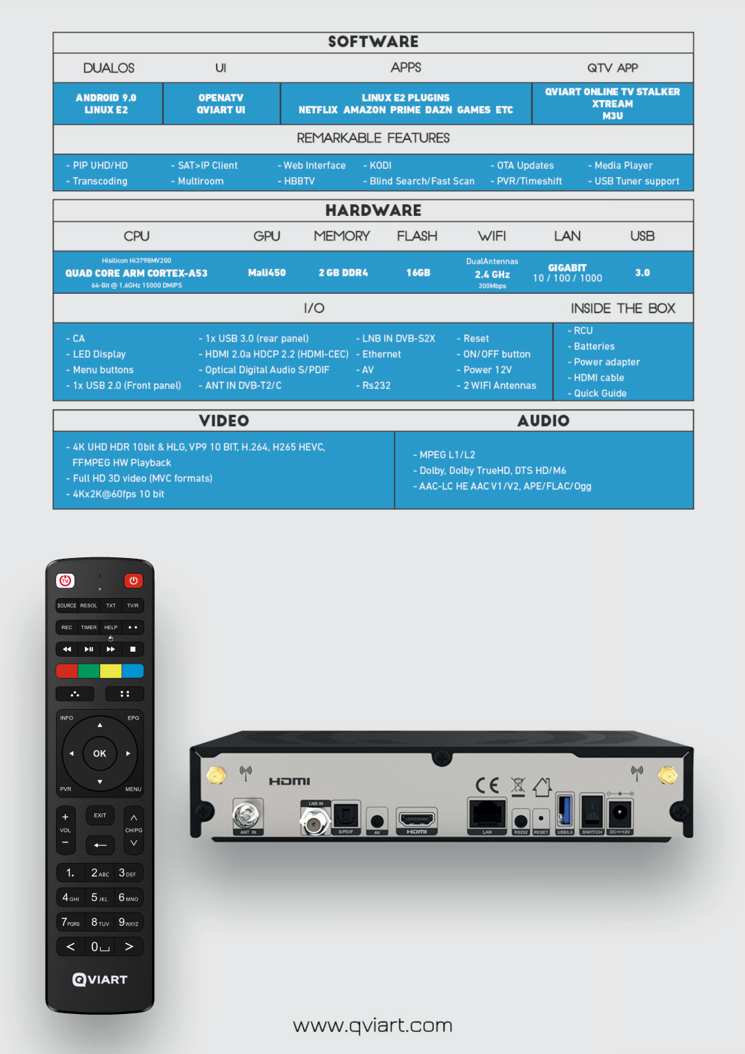

If you need the aerial input the Qviart Dual could be an option but be aware that the software is in it's infancy. There's a few threads on here about it if you search.Does anyone know if the viark can be connected to an aerial port or does it have to be directly connected to the lnb?

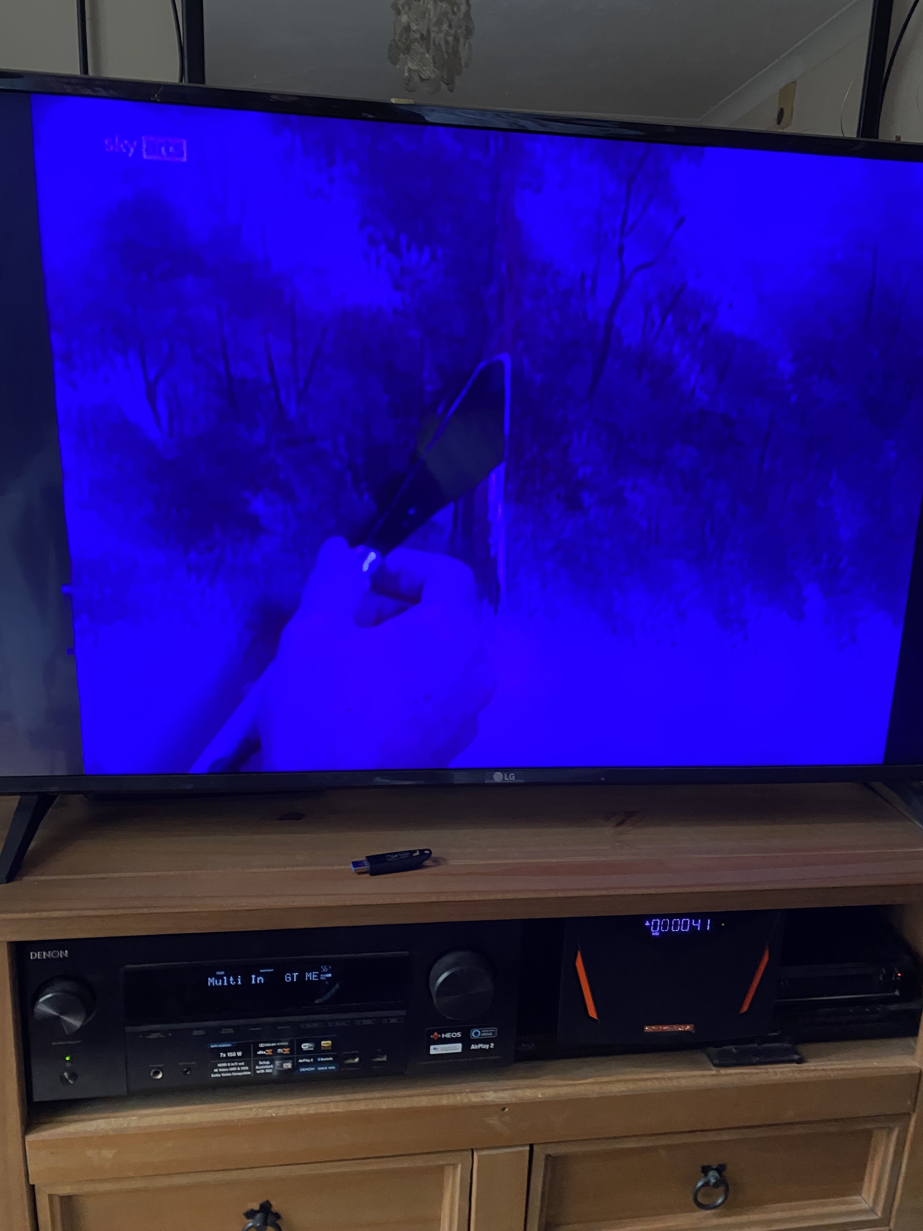

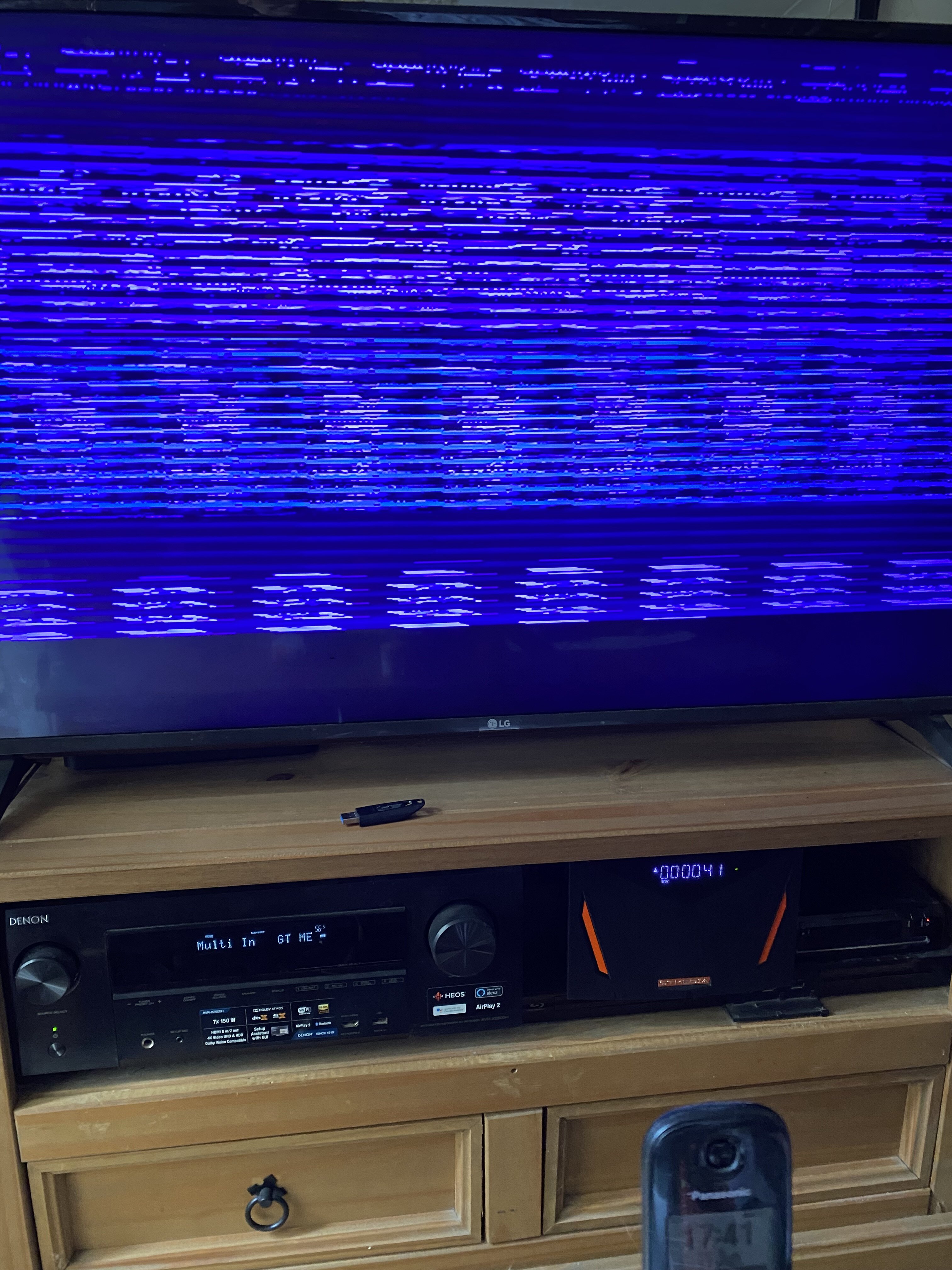

Not sure how the menu gets corrupted.Hi i need a bit of advise i have updated my gtmedia v8uhd to the lates software and the menu is corrupt how can i factory reset ?as i can not see the menu ?
Have you tried removing the hdmi cable and reconnecting it to see if that resolves the issue ?
Had this issue few days ago but that due to my mistake. I just remember the pattern to reset the box. So try following this Press Menu> Right Arrow (Installation)>Press ok> Enter your password> Press down arrow 7 times> Press Ok> Right arrow once> presss Ok> Then press right or left arrow doesn't matter > press Ok. It will reset your box all settings.But picture works fine ?
what password ?Had this issue few days ago but that due to my mistake. I just remember the pattern to reset the box. So try following this Press Menu> Right Arrow (Installation)>Press ok> Enter your password> Press down arrow 7 times> Press Ok> Right arrow once> presss Ok> Then press right or left arrow doesn't matter > press Ok. It will reset your box all settings.
how many times right to get to intallation ?try 0000 by default
