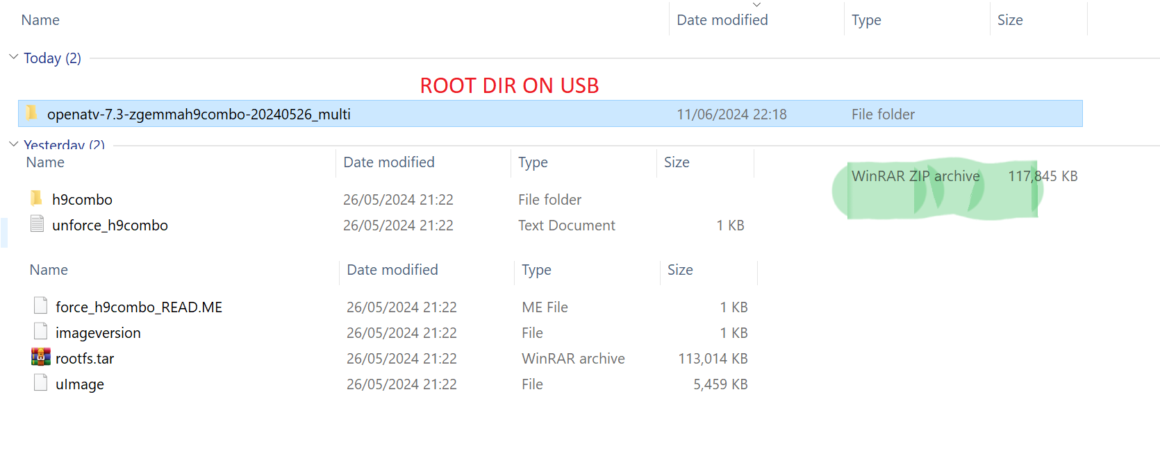

Thanks but still can't get to the flash or boot manager option
Image file and USB dir structure below
Am I reading his correctly going by image posted you should not have folder, example openatv-7.3-zgemmah9combo-20240611_multi
but it should only be folder h9combo and unforce_h9combo.txt file
Yip I noticed that after posting and changed the root directory on the USB to suit (the screenshot was from the PC I'm bad but not that bad to put it on the USB stick 😆)
