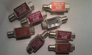

Try reducing the power being amplified as too much signal can cause adverse effects - so I've been told. Try putting it down so the levels are between 10db and 15db or the lowest you can go to without getting glitching.
